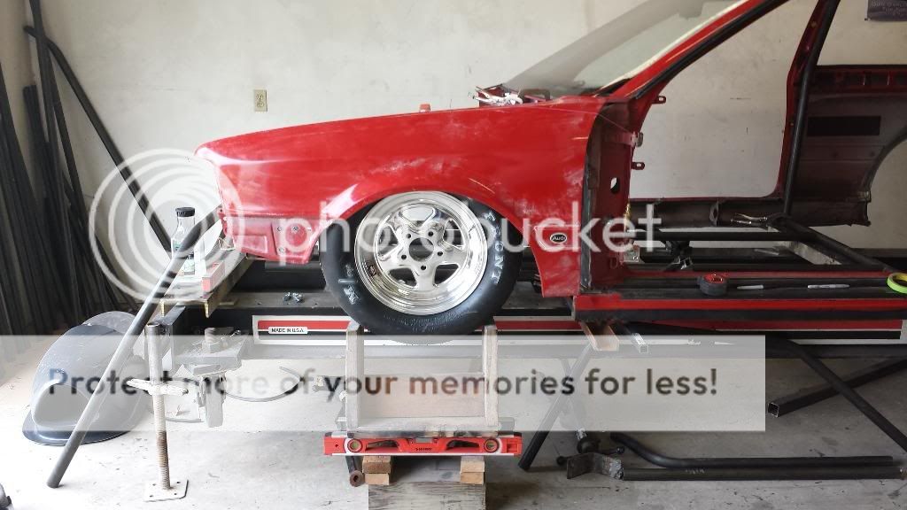

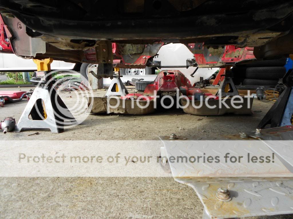

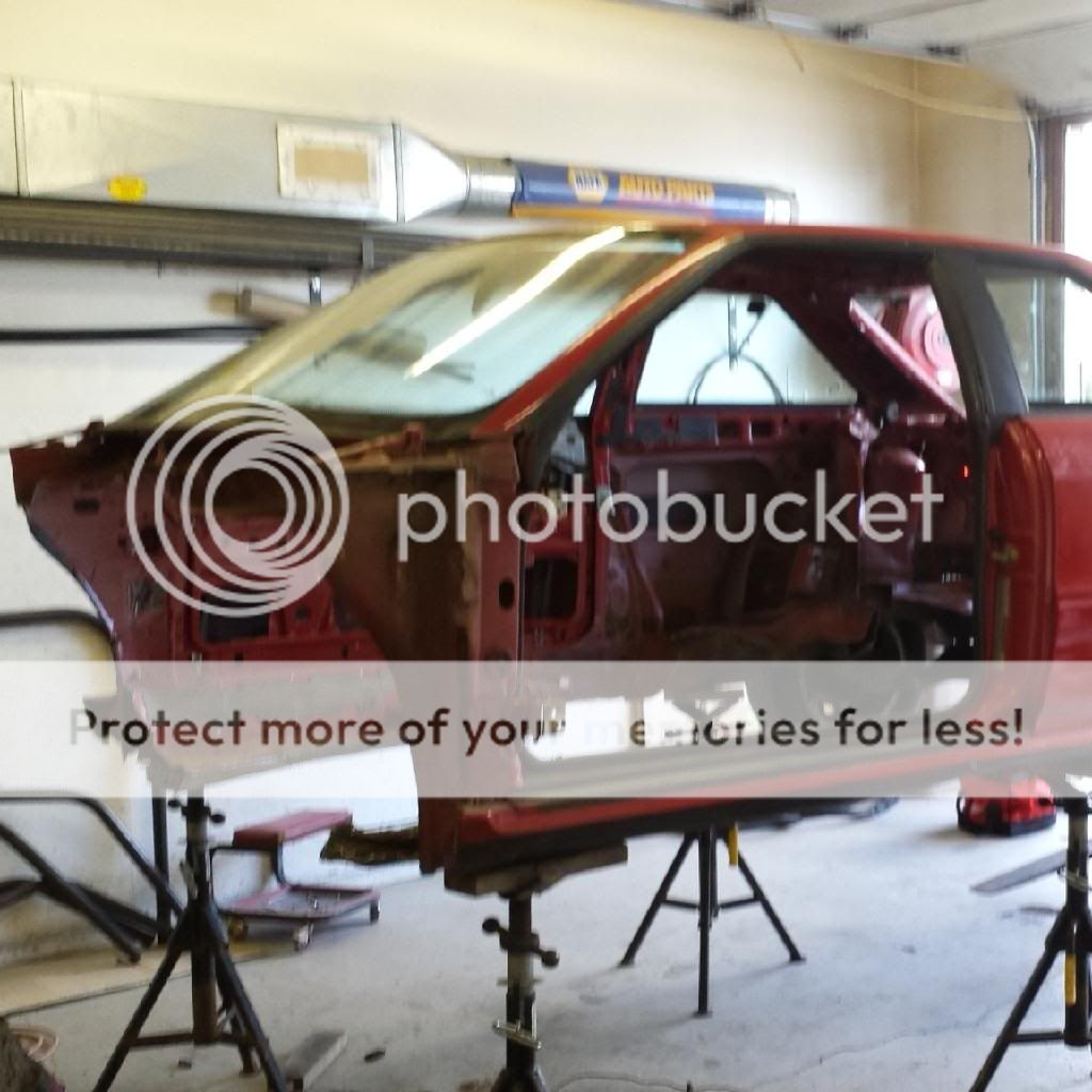

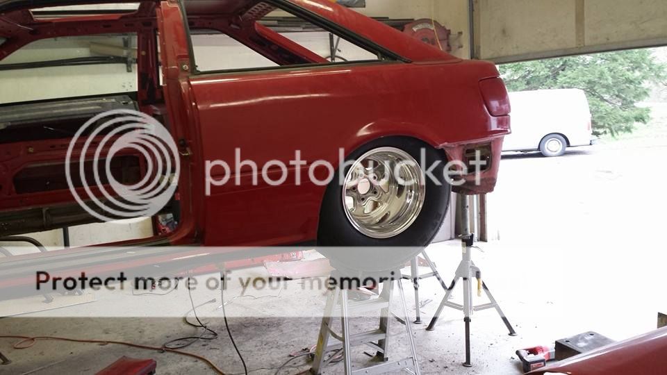

i have been working all year on a new chassis since my awd one is just ok, not fast enough for me.

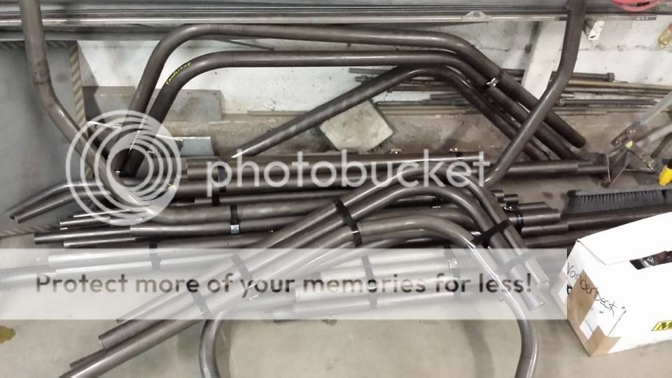

stepping up some, and started a 25.1 chromoly tube chassis RWD car using an Audi Coupe Quattro body and a 4 cyl 2.0L 20v stroker motor. the goal is 7.80's.....

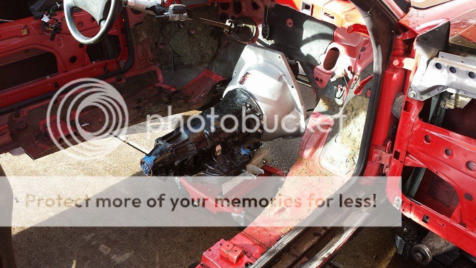

i gutted the car, and it is at a local chassis shop, Vanderbeck Race Cars. he builds some of the areas fastest cars..... funny cars, Top Sportsman, ProMod, dragsters, etc. I am so far doing all of the coping and tube work, but he is welding it and/or tacking it. he tells me what to cut/cope, and i do and then move on to the next step.
here is a few pictures so far of the progress. i do not plan to have this car up this season, i still am running the 9.30's / 167 mph AWD Coupe Quattro all wheel drive this season. i figured i just got the chassis cert'd again this past July, and this new car will not be up this year so dont take apart the running car. besides, there really isnt anything off the now car i need for the new car. and it was a lot of work to go backwards and be down all year anyways. this process started out as a backhalf/4-link, then a 3/4 chassis car, and then i just said fuck it, if i am gonna go i may as well go all out and am just doing the full chassis car. Advanced ET or Super Pro class i think is what i want to run.
i do have my own website with MANY pictures and daily updates.... check it out: http://www.speeding-g60.com and it has its own dedicated page for this chassis, as well. http://speeding-g60.com/?page_id=1081 and the daily updates are located here: http://speeding-g60.com/?page_id=282

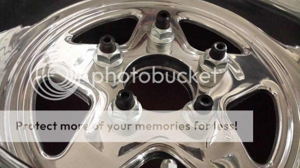

but it will start out with a 315/60-15 (30 x 13.50) on a 12" rear wheel, and eventually go to a 32 x 14 on a 14" or maybe even 33 x 10.5W on a 14".
and starting to collect my cool car parts. Chassis kit is Art Morrison Supercar kit for a Monza. all Strange suspension and brakes.

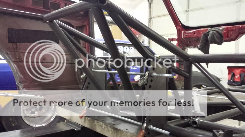

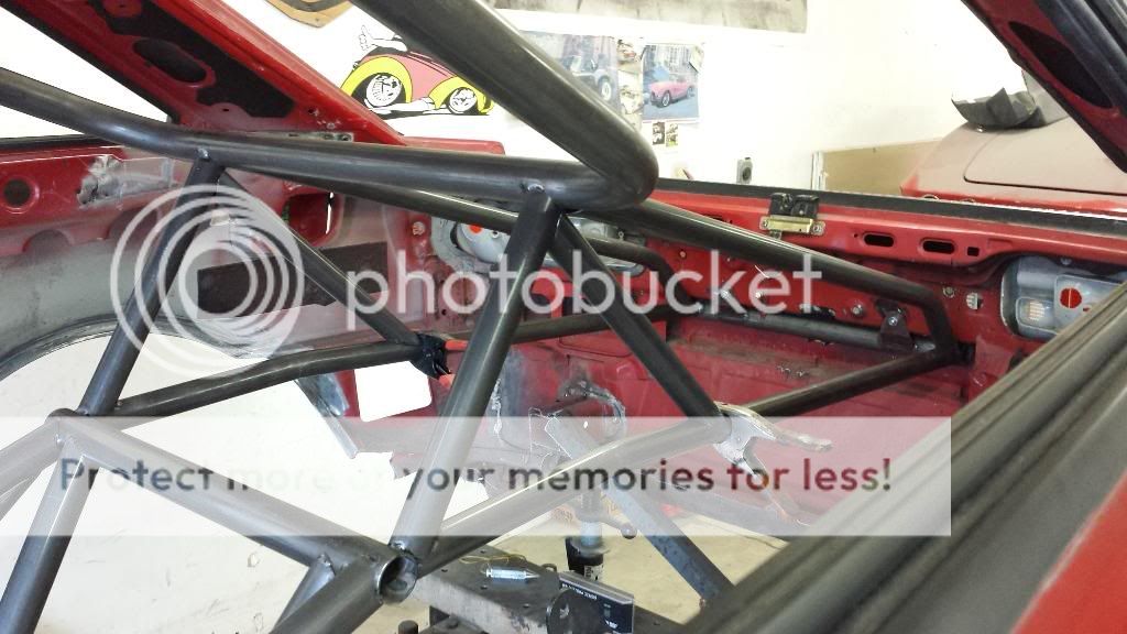

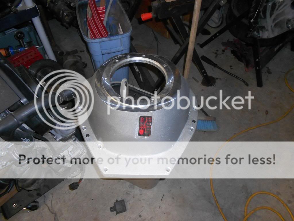

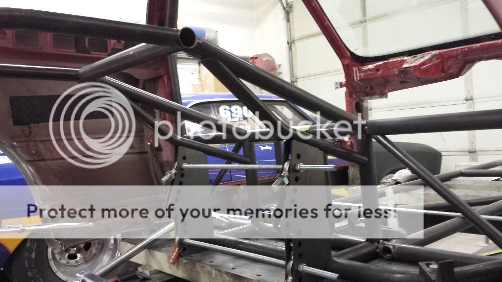

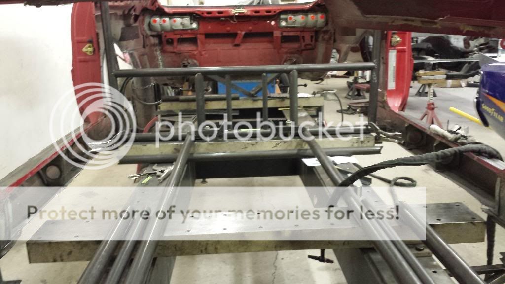

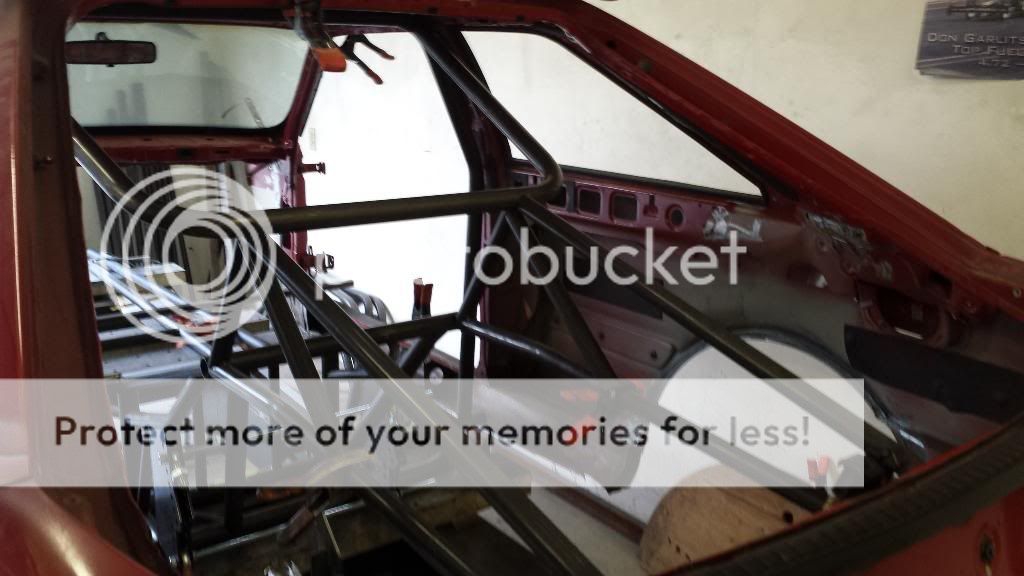

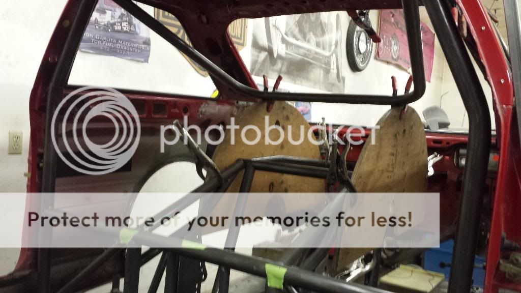

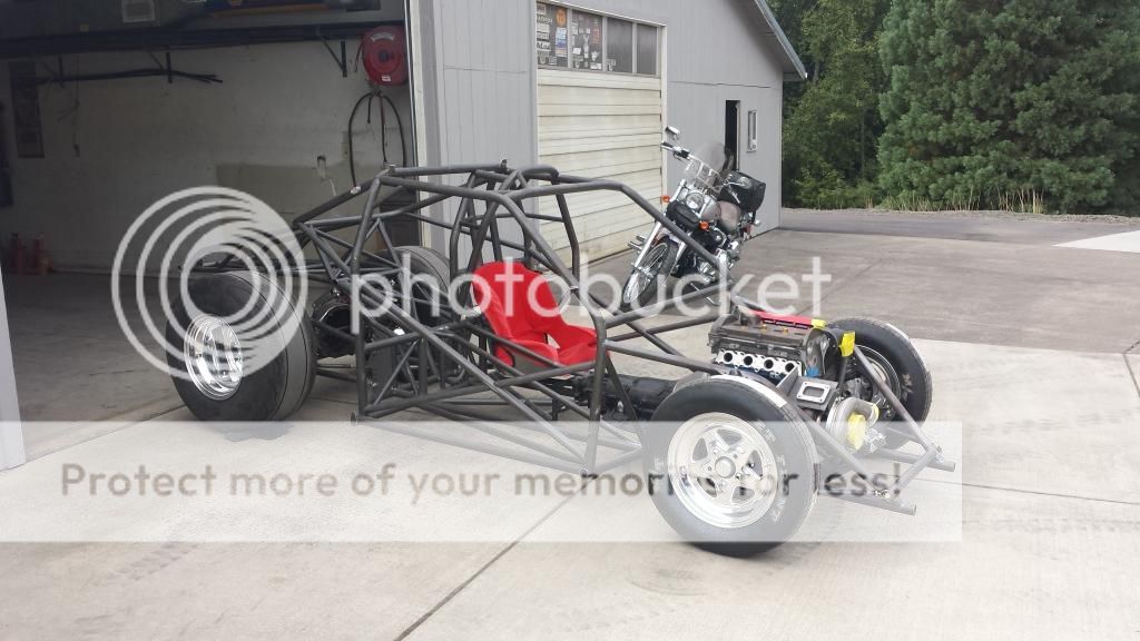

it is fun learning to do this stuff. i am a little bit further on now.
got a 3rd member for it. 4.30 lightened Pro gear, 40 spline lightened steel spool, Strange aluminum case, pinion support and yoke keeper loop thing, forged pinion.
and got the driver funny car cage portion done as well.

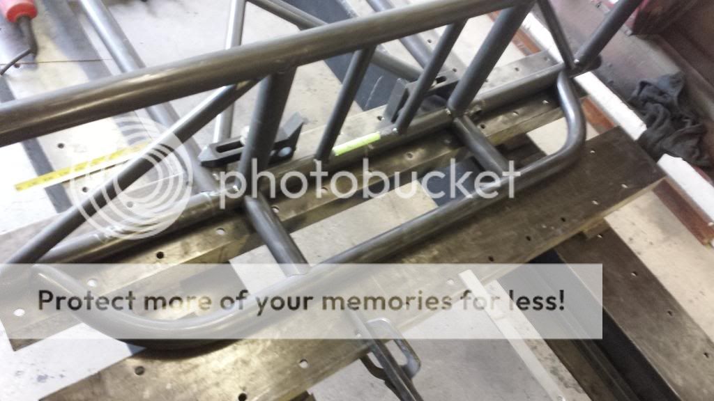

got the seat test fitted and more X-braces done. built the double rails for the tunnel and moving forward.

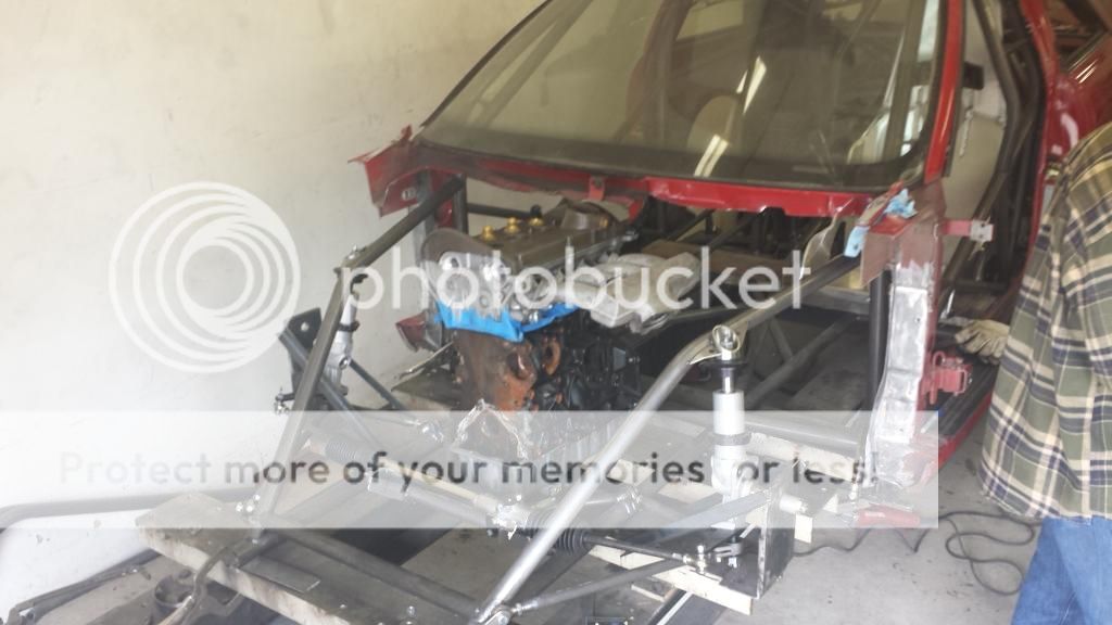

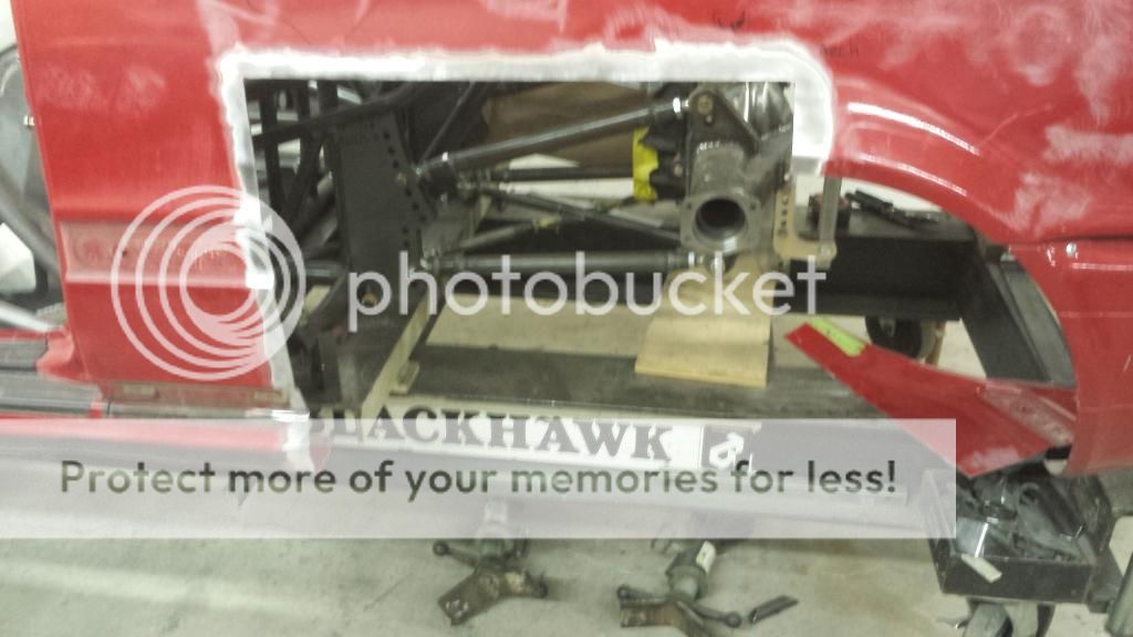

and played a little with an empty block/head to see how things look. the front plate is lexan just to make it easy to mess around with, once i get the exact location and what i want i will transfer it to aluminum and make the actual plate. stock intake manifold, again to visualize location and interference issues. i have an intake that is a stock replacement in mind, but it may not actually work out ideally for this setup. we will see.
but DAMN there is a lot of room in there. i think if the 4 cylinder doesnt do what i want it to do (and it should) or i get the yearning for more (we NEVER do that do we? haha) i will entertain the idea of an Audi 40v 4.2L V8 motor with twin turbos in its place. keep it Audi/Volkswagen at least for the motor, be different, whatever.

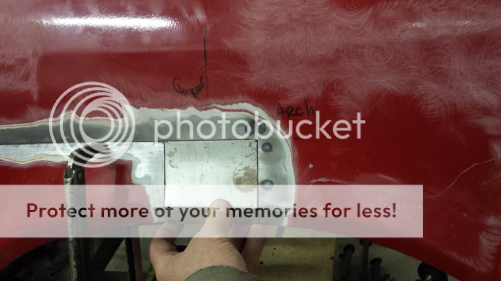

done a shit load more work, not in this order. this is the latest.

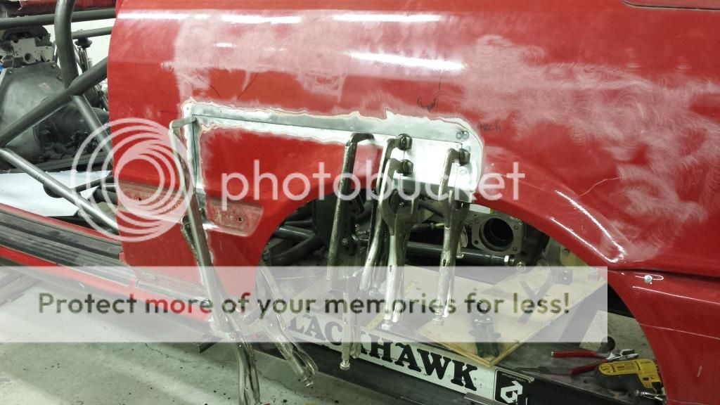

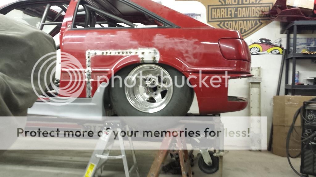

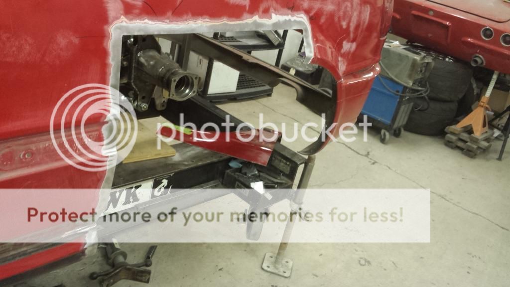

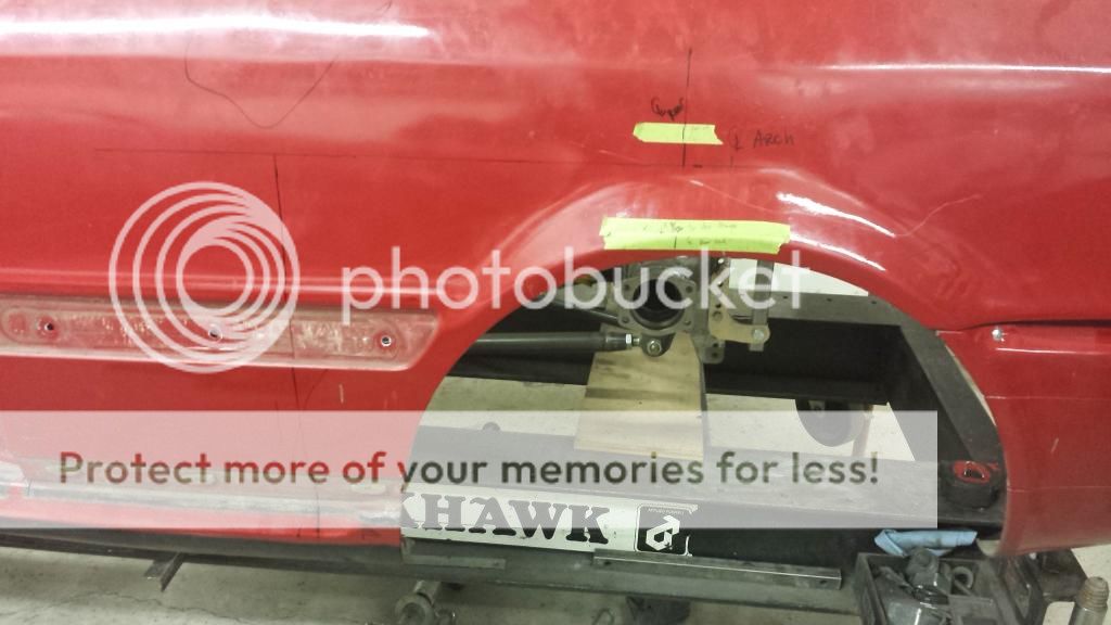

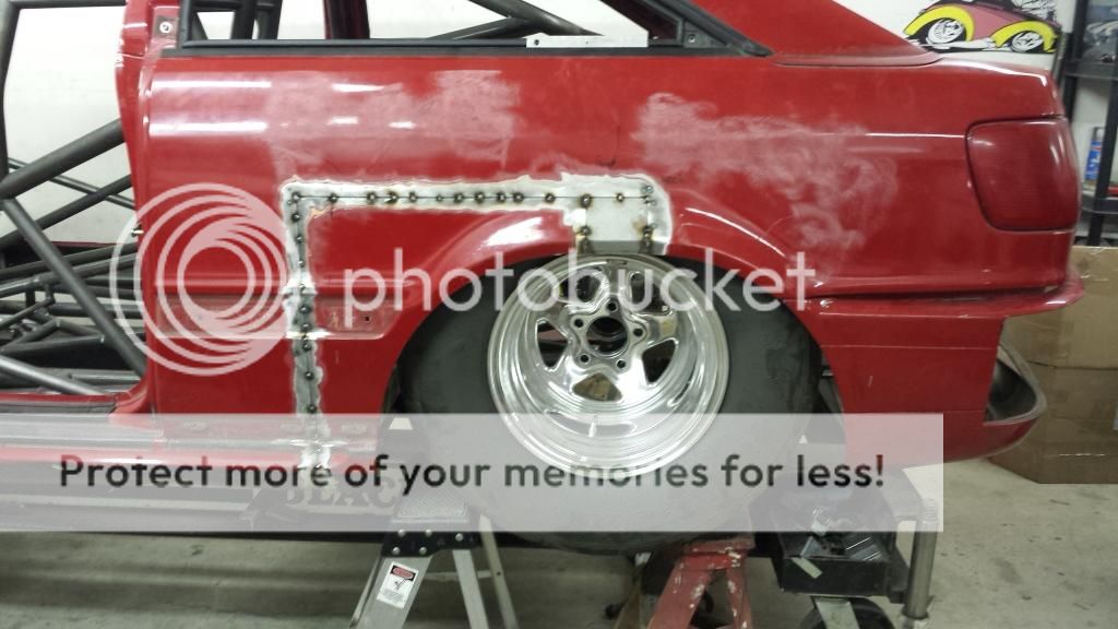

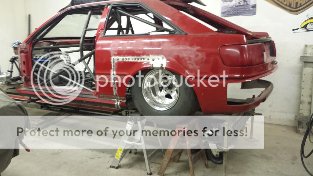

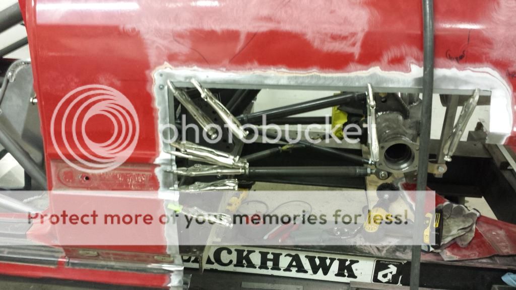

needed some room for tires. so i stretched the rear wheel arches 4" towards the front. the front end will be stretched completely (hood, fenders, etc ) the same 4".
done all of this myself with some pretty good guidance from an excellent chassis builder.
testing a 32" x 14" wide on a 14" wide wheel as this is the size i will probably run when i learn to drive this thing.
both sides done and cut. only driver side reassembled.
putting 3/4" backing strip in so we have something to weld to. sheared all of these strips. and the complicated section at the body moulding area, i used factory material there and split it .
hand formed the filler plate.
as he tacks these spots, he pulls the body work out and then tacks it. to keep its shape and prevent warpage. its not completed yet but it is visually good for clearance. and this is the wheel/tire i will use for the street. 315/60-15 on a 12" wide wheel, aka 30 tall by 13 wide. these are my training wheels so to speak. and YES it will be titled and reg'd and streetable.
then a trial fit with the side skirts. gonna be sorta low there :o

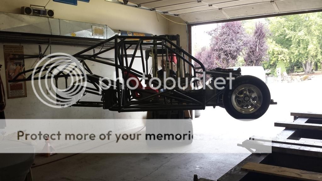

test fitted some engine stuff, like turbo and cell and stuff. made engine front and mid plates, and the front end is now welded out.
sighting the mainline to pinion center.
welding the front out (not me)
made the trans mount. also serves as a thrust block of sorts.
